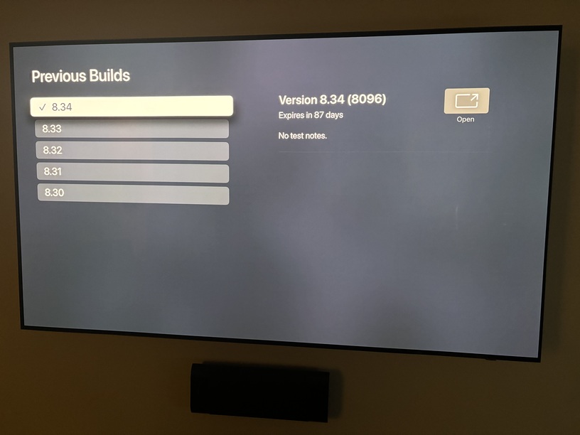

I received the invite code, but wasn’t given access to 8.34. I was in the regular beta, and if I tell TestFlight “Stop Testing” it freezes. Restarting TestFlight, the ‘old’ beta is still there. Putting in the invite code just sends me to the 8.33 beta I’m already on.
I’ll check this today :+1:
:joy: “(8096) No test notes” that you?

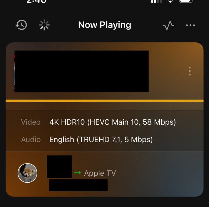

Sorry to report video quality is unwatchable on 8.34(8096).
ATV4K(2022) > Denon AVR > Samsung QDOLED.
8.34(8096), color banding, washed out. Samsung TV still reports HDR in its top info bar. PlexDash reports Directstream.
Comparing to Infuse. PlexDash reports DirectPlay.
Video
Format                                   : HEVC
Format/Info                              : High Efficiency Video Coding
Format profile                           : Main 10@L5.1@High
HDR format                               : SMPTE ST 2086, HDR10 compatible
Codec ID                                 : V_MPEGH/ISO/HEVC
Duration                                 : 1 h 44 min
Bit rate                                 : 58.2 Mb/s
Width                                    : 3 840 pixels
Height                                   : 2 160 pixels
Display aspect ratio                     : 16:9
Frame rate mode                          : Constant
Frame rate                               : 23.976 (24000/1001) FPS
Color space                              : YUV
Chroma subsampling                       : 4:2:0 (Type 2)
Bit depth                                : 10 bits
Bits/(Pixel*Frame)                       : 0.292
Stream size                              : 42.6 GiB (90%)
Default                                  : Yes
Forced                                   : No
Color range                              : Limited
Color primaries                          : BT.2020
Transfer characteristics                 : PQ
Matrix coefficients                      : BT.2020 non-constant
Mastering display color primaries        : Display P3
Mastering display luminance              : min: 0.0050 cd/m2, max: 1000 cd/m2
Audio #1
Format                                   : MLP FBA 16-ch
Format/Info                              : Meridian Lossless Packing FBA with 16-channel presentation
Commercial name                          : Dolby TrueHD with Dolby Atmos
Codec ID                                 : A_TRUEHD
Bit rate mode                            : Variable
Bit rate                                 : 4 572 kb/s
Maximum bit rate                         : 7 779 kb/s
Channel(s)                               : 8 channels
Channel layout                           : L R C LFE Ls Rs Lb Rb
Sampling rate                            : 48.0 kHz
Frame rate                               : 1 200.000 FPS (40 SPF)
Compression mode                         : Lossless
Stream size                              : 3.35 GiB (7%)
Title                                    : TrueHD Atmos 7.1
Language                                 : English
Default                                  : Yes
Forced                                   : No
Number of dynamic objects                : 13
Bed channel count                        : 1 channel
Bed channel configuration                : LFE
logging.zip (1.1 MB)
