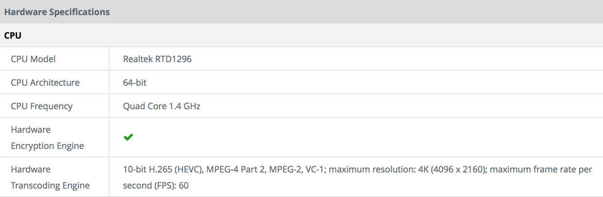

The DS118 do have H265 Hardware acceleration (4K) https://www.synology.com/en-global/products/DS118#specs

I attached the DS118 Specifications, which shows H265 Hardware acceleration 4K 60fps (Transcoding support)

I am aware it is supposed to be there. Synology has a proprietary HW transcoding. We’ve tried to get access to it to no avail.
