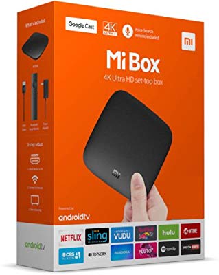

I can vouch for the Shield as well. I also recently got a Mi Box, and that thing has been great too. It seems to do everything the Shield does, but at a lower price.
Which Mi Box did you get?
I am looking for a client that can direct play 4K MKV video files with HDR and DTS audio.
This one:
I have noticed one difference between it and the Shield though. On 1080p with bitmapped subs (pgs/vob), both the Mi Box and the Shield can direct play it. On 4K with bitmapped subs, the Shield direct plays it but the Mi Box requests transcode.
