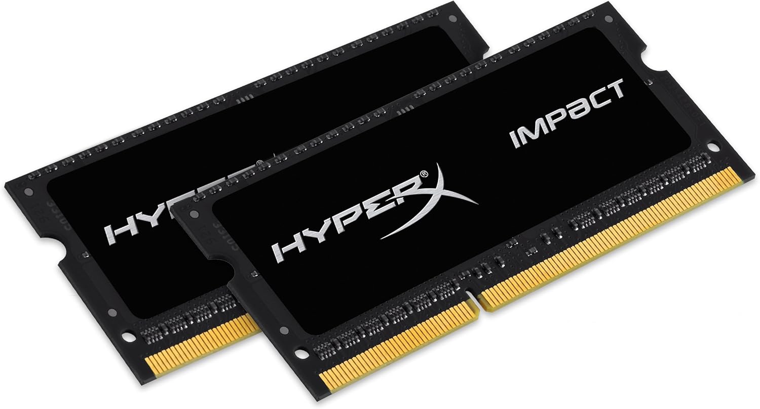

For Synology DS1815+ and other processors which support 8GB onboard using two slots, a forum user proved his point to me very nicely. He runs 16GB in a DS1815+ (overkill to me) but with the release of Docker,etc. 8GB of matched set (dual channel) memory is very performance friendly for the processor. No more two-access memory operations to retrieve what’s needed.
As reference, I am running this.
If you do this, take your time unlocking the memory behind drive 1 with your fingers (or Popsicle stick), you don’t want to bend the locking clamps. Once unlocked, lift slowly , twist 90 degrees and out it comes between index and middle finger. :smiley:
I think talking about additional ram is a bit early. But on that note I could not get the 2X 4gb to work. Tried both slots with all variations and eventually settled for the original 2gb and one new 4gb.= 6gb.
The key is using a matched pair. The MMU in the processor is sensitive to that. Intel chips always have been.
Additionally, the specs for the memory I posted here match the module supplied by Synology except is, IIRC, 1 clock faster on latency.
Yep the 2x4gb chips were/are matched. Didn’t work for me.
Now I likely have an unmatched pair! :)>-
