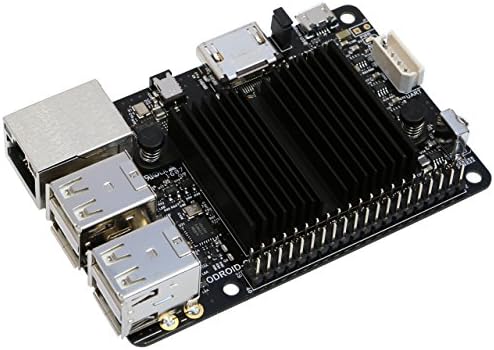

Yeah an Odroid C2 running OpenPHT will direct play nearly everything you throw at it, including HEVC and 4k.

Camnchar - You mentioned the ODroid, what would be the min specs I would need accomplish this?

If you get the odroid from Amazon, you can always return it if it doesn’t meet your needs.
