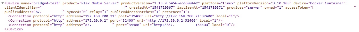

I gave bridged mode network a try…and did a clean installation, which of course works as expected…
The relevant part of the docker-compose.yml:
  - ADVERTISE_IP=http://192.168.200.21:32400/
  - ALLOWED_NETWORKS=192.168.200.0/24
When just ADVERTISE_IP is used the PMS instance can’t be accessed. When ALLOWED_NETWORKS is used, accessing the server works like a charm
The resulting registration looks like this is in the resources.xml:
Thus said: is the compose.yml from above your real configuration? If so, why do you publish ports when you use “network_mode: host”?!
Whatever causes your problem, it is definitly not a general problem of the docker container used in bridged mode!

Just for the sake of completing the tests:
Regardless whether the ADVERTISED_IP points to https or http, the value for local is always 1.
Obviously the pub-sub service does not care if a https “Custom Server Access URL” has a valid certificate or not. Which now where I think about it makes sense since it rather uses the ip for “connectivity test” and not the domain name.
For each test a new Plex instance using a new PLEX_CLAIM token was created and the Secure Connection setting was set to “Required”, then the remote connection was disable/re-enabled and afterwards the resources.xml was checked.
You should create a new instance and check whether the local recognization is working for the new instance (I used no volume mappings for this) . If it does work as expect, you know there is a problem with your existing config.
