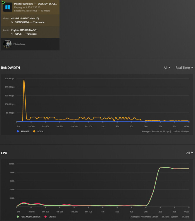

Let me be clear that the tone mapping works, it’s just not hardware accelerated. I can see this is the case since theres no (hw) marker on the dashboard, and the CPU usage is pegged at 100%.

Sorry, my phrasing must have been weird.
In any case, I did mention that the CPU usage was maxed out. It can’t even transcode a file from 4K HDR HEVC to 1080p without hitching every couple of seconds. I think the hardware should be more than able to handle a single tone mapped transcode…
Those ratios are not bad for this CPU.
You’re converting audio DTS → Opus which takes a fair 30%-ish.
The actual HW decode & HW encode is about 15%.
The CPU shuffling data in and out of the GPU for the tonemapping is harder on these J & N series CPUs than it is on the “Intel Core” processors because of the internal PCI bus bandwidth.

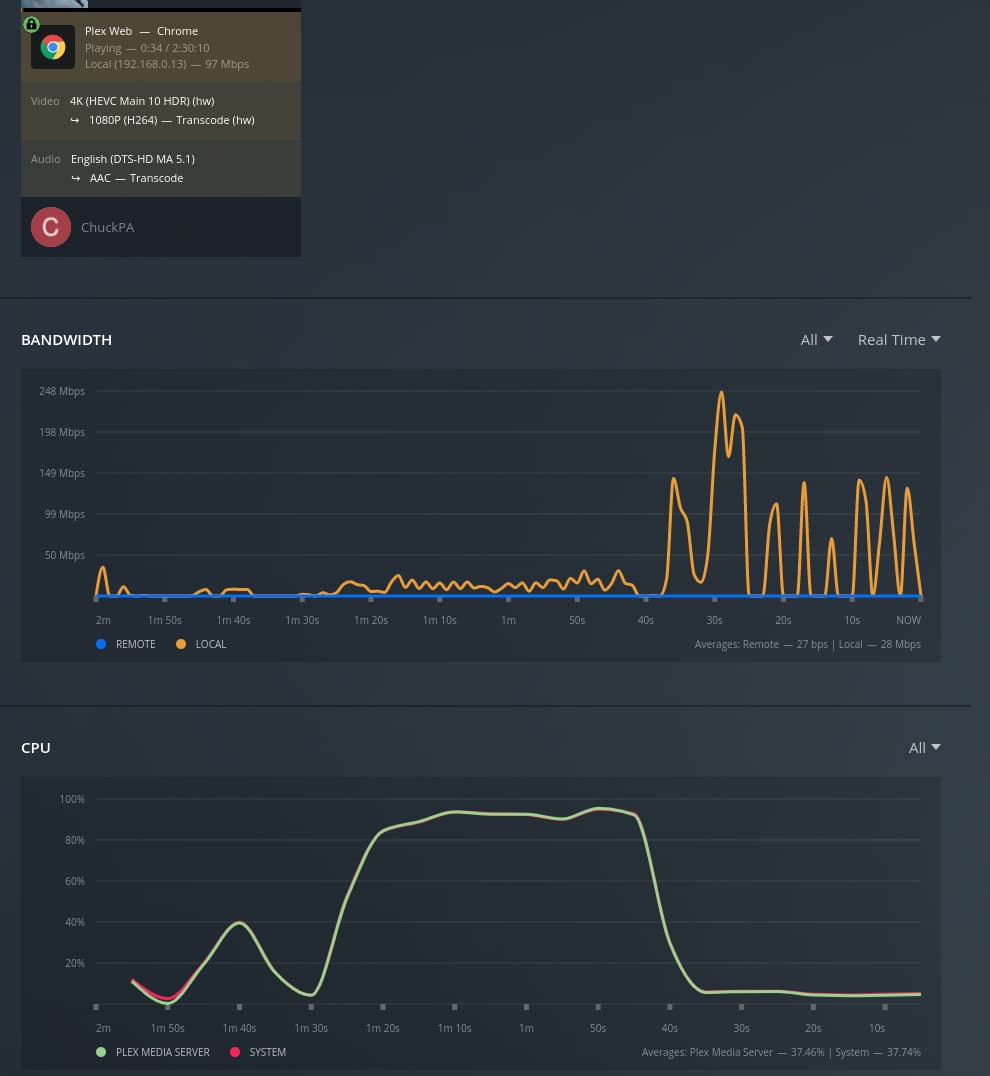

Here is your same movie playing on a NUC8i7HVK (i7-8809G CPU) (8900 Passmarks)
Even here, with hardware tone mapping, You can see the load.

@ChuckPa I understand that the ratios seem normal, and I do believe that these are normal usage levels when tone-mapping.
However, I’m sure it is not using hardware acceleration:
  • For starters, if I disable hardware acceleration, the CPU usage profile is identical to when I have it enabled when tone-mapping.
  • Secondly, the performance is equal, and the stream needs to buffer every two seconds. I would expect that if it were using hardware tone-mapping, the performance would result in, at least, a watchable stream.
  • Finally, and most importantly, using intel_gpu_top from intel-gpu-tools, I can actually confirm that no GPU activity is going on in the alleged hardware transcoded tone-mapping.

This is the error I see in the console:
I will attach the logs, this time hopefully with debug enabled (I checked manually).
Plex Media Server Logs_2022-08-08_19-35-59.zip (378.8 KB)
Let me know what I can possibly do to get things working. It’s been quite a pain having things break when they were working so well before. Again, thank you for your endless support.
