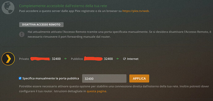

I would like to expose you a question about remote access, I need to expose PLEX through proxy reverse with NGINX on a virtual machine hosted on proxmox and close port 32400 on the modem/router to the virtual machine where the PLEX server is, how can I then tell it when do I remotely log in that PLEX must reach it on the other virtual machine? it can be done?

i tried and it works, but how do i tell the server to fetch from the new ip instead of the ip of the machine where the server is located? because if I log in from the remote access page it always gives me the IP of the machine where the server is hosted and not the one where I have NGINX, I would like the machine with NGINX to act as an intermediary.

Deactivate remote access. Plex will always only see your nginx IP and use that as reference for “remote access”. The real-ip is in the header, which plex doesn’t care about and just logs.
Enter your custom domain / public IP in the network tab and the rest is nginx https->32400 local

I solved, some clients do not accept https to stream content and I had to remove the redirect from http to https.
Now I see everything perfectly even remotely having nginx doing it by, adding in the network settings custom URLs for accessing the server
https://plex.domain.net:443,http//plex.domain.net:80
