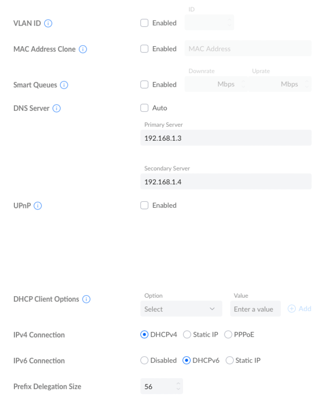

My ISP provides me IPv6 with /56 prefix delegation, say for example:
d568:40fd:487:1665::/56
Each of my devices have the IPv4 and IPv6 assigned by a Unifi UDM SE router with DHCPv4/6. Since I need to access IPv6 only websites, I cannot disable IPv6 on my network.

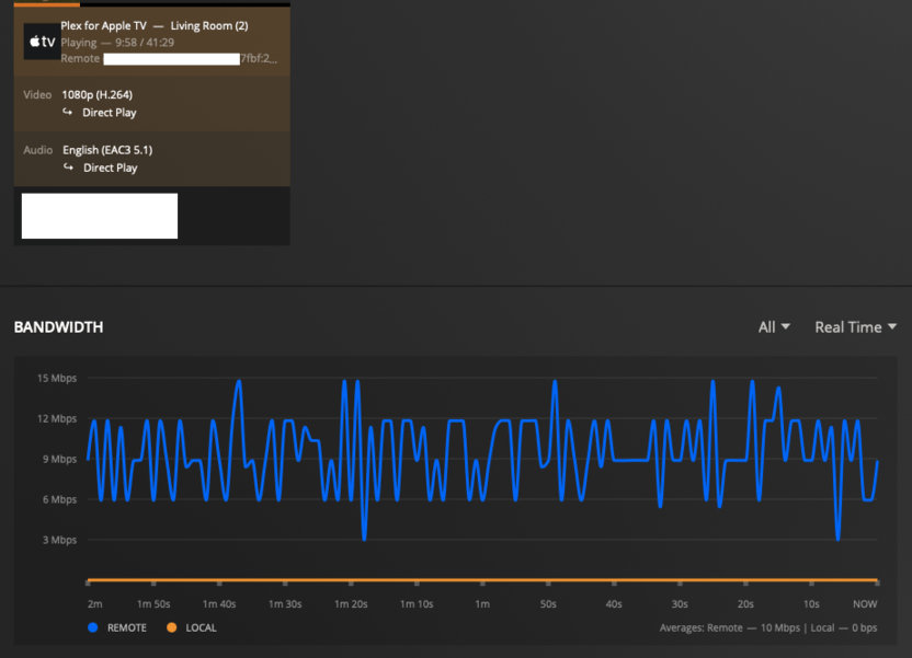

If I insert into LAN Networks 192.168.0.0/16,d568:40fd:487:1665::/56 and play a video into browser or Apple TV, it will play as Remote, not as Local. Into logs, I see the following error:
Error parsing allowedNetworks 'd568:40fd:487:1665::56': Invalid argument

With nothing defined in LAN Networks, when I play a video on my web browser, it shows as Remote into Plex Dashboard while using an IPv6 address. Since each device has both addresses assigned by router, I would expect Plex to use the IPv4 address.

So I did more troubleshooting, I created a network where only IPv4s are allowed and moved the Apple TV into it. I’ve set the Internet Streaming to 4Mbps 720p and started playing a 1080p video. To my surprise my ISP public IPv4 was displayed as Remote into Dashboard!

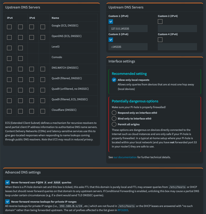

My assumption is that your local DNS resolver is applying “DNS rebinding protection”. This prevents secure connections from working in the local network. The solution is to add the domain plex.direct to the list of exceptions from that protection.
I use two Pi-Hole combined with unbound running on two raspberry pi, for my network DNS.
Not familiar with plex.direct domain, is this an actual resolvable domain name.
Every Plex server is assigned a subdomain on that: https://support.plex.tv/articles/206225077-how-to-use-secure-server-connections/
At the bottom of that article you can find some examples how to add the domain to popular DNS resolvers.
I added the configuration:
echo 'private-domain: plex.direct' > /etc/unbound/unbound.conf.d/plex.conf
I cannot tell you whether that is wrong or right, as I’m not using this software myself.
The information is correct, I posted it in case someone else has the same issue. Thank you, I did not know about this setting.
Edit: Enabling private-domain: plex.direct in Unbound invalidates the Custom server access URL setting and my server libraries are not available anymore in either app.plex.tv or my Apple TV app. I use a real https://plex.domain.com domain with valid certificates.
