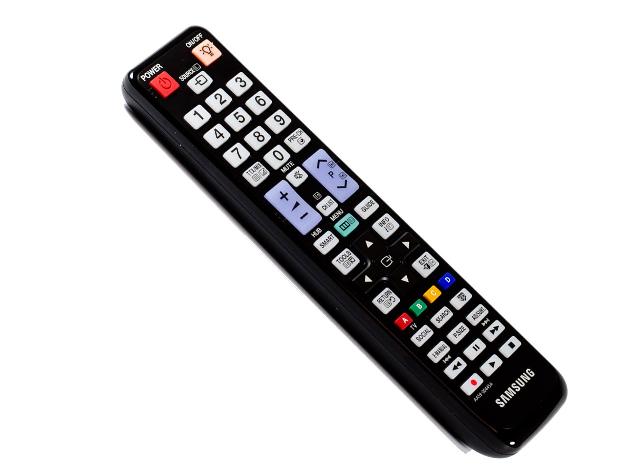

See attached my custom remote.xml file for my Samsung TV remote.
It fixes the Return and Exit buttons on the remote, which drove me crazy until I used trial and error to eventually fix everything about a year ago.
RETURN button: goes back a screen
EXIT button: goes back to Home screen
Green button: Shows metadata info during playback
Yellow button: Shows context menu
Blue button: Toggles subtitles during playback
Red button: goes back to Home screen (same as EXIT button).
Some of the buttons on the remote that you think would be good for Context Menu, Settings etc cannot actually be mapped as they are reserved for Samsung (eg Tools, Info and Menu buttons)
Rename the attached to remote.xml and copy it to your userdata/keymaps folder. Works in my case for both PHT on a Windows machine (using a HDMI-CEC adapter) and Rasplex on the pi / pi2.

Samsung TVUE37D6350
Samsung Remote AA59-00445A (delivered with TV) http://ecx.images-amazon.com/images/I/611LE4ewlJL._SL1280_.jpg
RaspberryPI2
Works like a charm.
Note: pressing "Guide" button reboots my Raspberry PI. Have to change that one.... :-)
