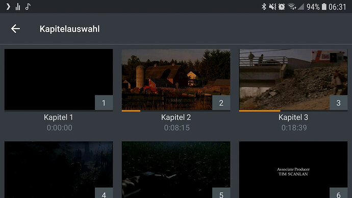

In the beginning I used MakeMKV to rip my DVDs and later in the Plex, I had always for each chapter a thumbnail. See the follow picture

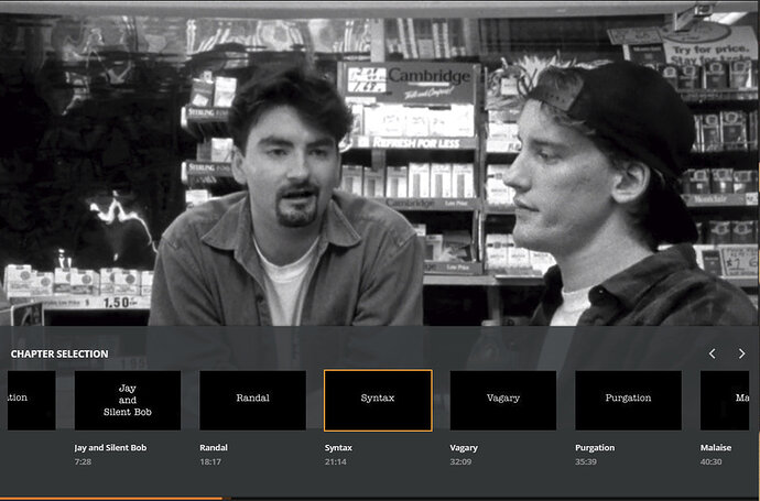

Unfortunately, I had to change from MakeMKV to Handbrake and there now these chapter thumbnails are missing. See the next picture
Are these thumbnails saved directly in the mkv file? Or from where exactly get Plex this chapter thumbnails? Can I add my self chapter thumbnails?

Unfortunately the chapter thumbnails are still black. Is it possible, Plex generate the thumbnails, but unfortunately it’s always black pictures? When you have a look to my first post, (Printscreen number 2 the 3 picture), there we can see, the thumbnail is not 100% black. We can see there is something like bridge.

Is it possible that the chapter breaks coincide with a black screen in the video file? The chapter previews could have been picked at this exact moment.
They can be quite precisely placed, as this example illustrates:
The Multi-Episode-Files I can easy split in multiple files. so i can be sure that the episode order is correct.
@JuiceWSA, @OttoKerner, I think you guys are right, I could check it quickly by one episode and there is really when the chapter change for one second a black screen. I think its not possible I can add own thumbnails? Or change timestamp from Plex to take this thumbnails?
