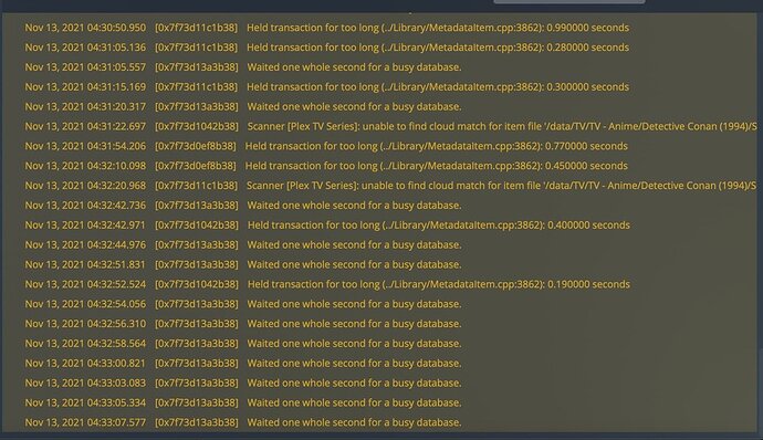

Wondering if anyone could help me as I am at my wit’s end.
Running Plex on a docker container on a fresh new box.
Could someone please confirm if it’s normal to have a whole host of “waited one whole second for a busy database” or “Held transaction for too long”
I’m doing a scan of a library and don’t recall this being issue, but then again, maybe I wasn’t paying attention to the console.
Can attach logs once I can properly sit down (let me know what logs do you need as I’ve downloaded them from the server), but in the meantime if someone is able to shed light on this with limited Information, I would appreciate it!
Screenshot attached.
May I have the actual DEBUG logs ZIP which capture this?
The usual causes:
  1. CPU overloaded (software transcoding - burning subtitles)
  2. Ingesting a lot of media
  3. A fragmented database (most common cause)
Thanks for the reply @ChuckPa
Thanks for the logs.
Yes you ARE Ingesting a lot of media.
As a suggestion – Have you considered moving the metadata to a SSD ?
If you do that, database & metadata performance will skyrocket (up to the 535 MB/sec speed of SATA-3 / 2.7 GB/sec for NVMe Gen 3 - 4 Lane)

Ok, then it must be time to Optimize the DB .
I know you’re ingesting media. (which leaves deleted , but not removed, records from the update process)
This optimization will cause ingestion to pause but it will recover by itself.
Optimize the DB and then look at the logs in a little while. You should no longer be seeing the busy database

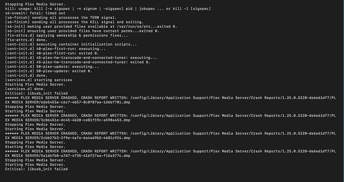

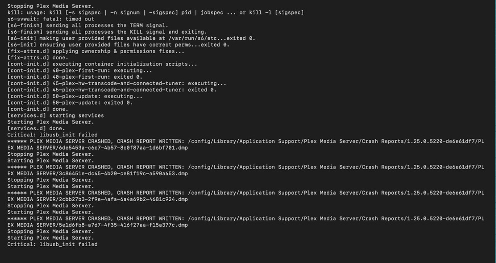

Meh still having issues.
Anime library was added, optimised database. So far so good.
Restarted the container, added the movie library. BAM, Plex Media Server crash (from docker logs).
Still getting the same issues as before.
New logs attached
Plex Media Server Logs_2021-11-13_22-50-10.zip (368.1 KB)
This is bloody hopeless…

This is of course for this crash, however still doesn’t help me with my previous DB issue (which is still occurring).
At this point I just want to wipe the whole box and start anew, but to be fair, if this is a Plex issue, that might not help either.
I’ve wiped the whole thing again, reinstalled Plex yet again on docker with a brand new install…Same damn errors…
This is mind numbing…
@ChuckPa do the logs tell you anything?
@M3th0s
Those messages are actually meaningless. You’re seeing Engeering’s work in progress. The “invalid fields” are new fields being created for some of the bigger changes (internal mechanism)
I need the entire ZIP please.
I’ll upload logs again once I get home :slight_smile:
Plex Media Server Logs_2021-11-14_18-10-13.zip (2.3 MB)
Logs attached from a TV library being scanned after a full machine wipe.
How many Plug-ins did you add?
Nov 14, 2021 15:53:57.684 [0x7fc70f767b38] DEBUG - Waiting for 21 plug-ins to finish starting.
Nov 14, 2021 15:54:04.950 [0x7fc70f8dab38] DEBUG - Read configuration for [com.plexapp.plugins.WebTools]
