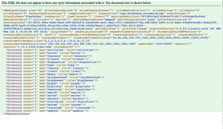

When I connect to localhost:38400 I get the screen shown in the uploaded picture. The Plex /config folder does contain a few log files although I’m unable to interpret them very effectively. The Plex Media Server log contains the following errors:

That XML is actually the correct response to /. You likely want /web/index.html.
