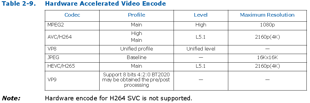

If you expect to have many simultaneous transcodes, look at the Intel Kaby Lake & Coffee Lake CPUs. Their iGPUs support the most video formats - h264, h265, etc.
Intel iGPU capabilities are listed in the CPU datasheets. See Technical Resources: Intel® Core™ Processors. The info is in the Volume 1 datasheet.

Here’s a couple of tables from the datasheet for the 8th Gen CPU. There is much more detail in the PDF.
