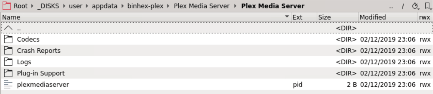

Okay thanks guys. Never actually mapped a /config (there wasn’t one to) setting in the docker setup but think I found it. Does that look like the right spot?
Yes, that looks correct. Though I’m not sure why you have a Plex Media Server folder within your Plex Media Server folder. That’s a bit strange.
That confused me too haha, and why I asked. This is what’s inside it. Don’t know why it’s there. Think it’s safe to delete it?
Try renaming it first to see if it breaks anything. If not, it should be safe to delete. Given that nothing in it has been modified in a year and a half, it’s likely safe to whack.
