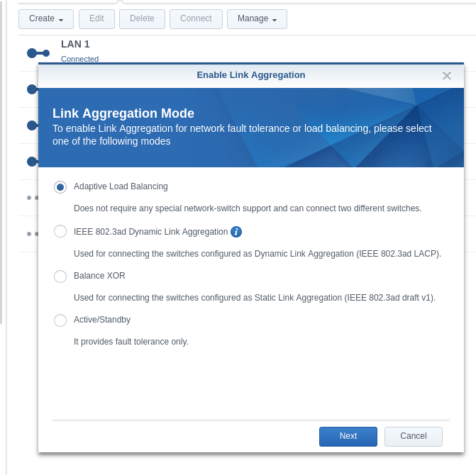

  1. Control Panel - Network - Network Interface
  2. Create a Bond adapter. (links both adapters as 1 for aggregated throughput)
  3. It doesn’t need a smart switch done as I show.
  4. It will take the IP of eth0
  5. Now PMS will see only 1 adapter and Synology will only have 1 adapter.

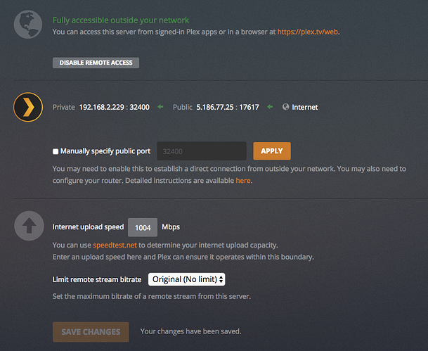

Here are the logs.

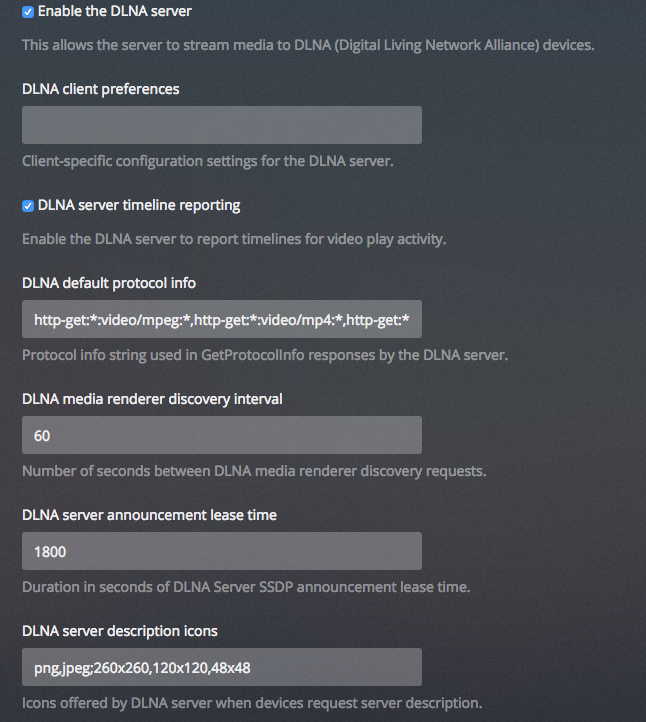

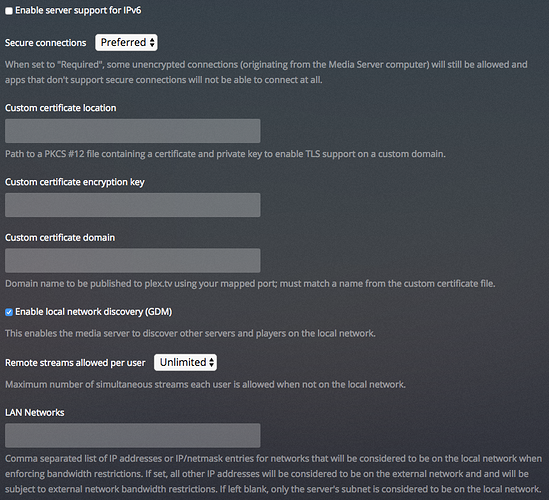

These are my settings:
Another resource screen shot:
  4. ** It will take the IP of eth0**

By bonding these two adapters, which present as two IP addresses to both your TV and PMS, into one address, Source IP and Reply-To IP (for the TV sake) is resolved to a 1:1 mapping.
It is a simple next step to take in resolving whether or not we have a network/communication issue
