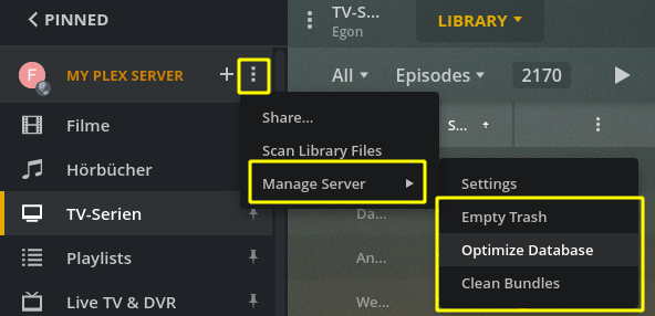

You can also run these tasks manually:
2020-07-16_13-59
