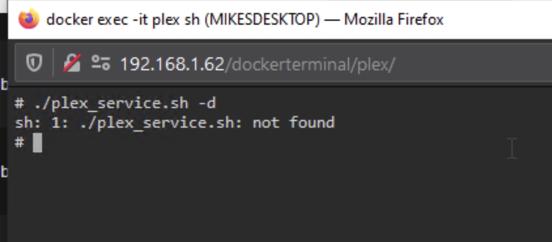

This was almost perfect for me, heres my horrible workaround when it didn’t work, probably because I did something wrong.
The stop services code didn’t work. I’m running the LSIO docker so maybe thats why but when I run it says service not found.
So to keep the docker running and be able to do the next steps this is what I did.
