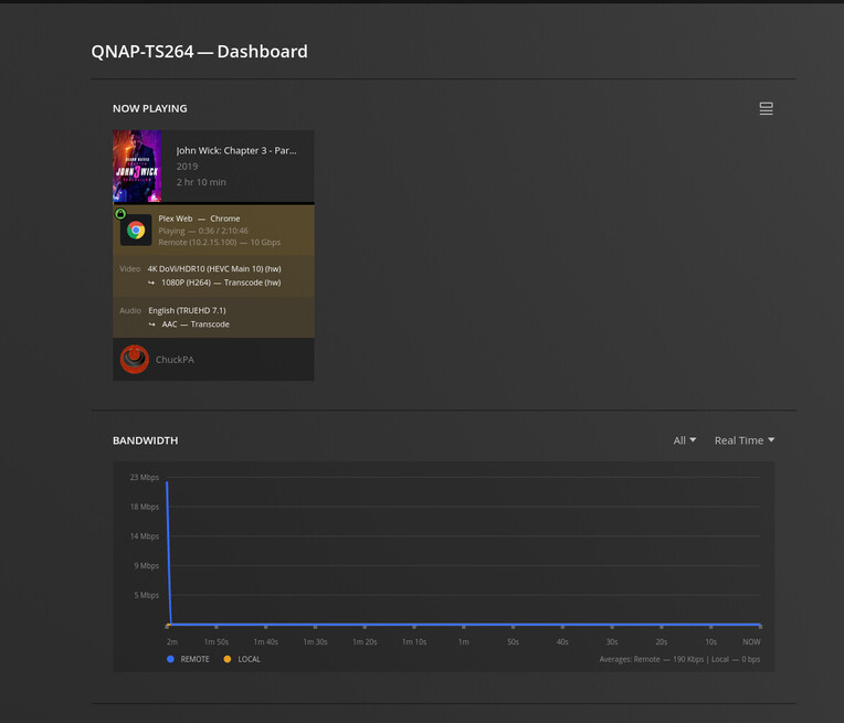

Folks,
Battling flu. Here we are. N5105, on a QNAP (which is more constrained than Ubuntu)
This is using the Engineering development build 1.31.2.6715 I have linked above.
[/share/Public] # uname -a
Linux QNAP-TS264 5.10.60-qnap #1 SMP Thu Jan 12 01:03:21 CST 2023 x86_64 GNU/Linux
[/share/Public] # cat /proc/cpuinfo | grep 'modeldecoder information: 249
[/share/Public] # cat /proc/cpuinfo | grep 'model name' | uniq
model name	: Intel(R) Celeron(R) N5105 @ 2.00GHz
[/share/Public] #

Followup:
Linux QNAP-TS262 5.10.60-qnap #1 SMP Thu Jan 12 01:03:21 CST 2023 x86_64 GNU/Linux
[/share/Public] # cat /proc/cpuinfo | grep -i 'model name' | head -1
model name	: Intel(R) Celeron(R) N4505 @ 2.00GHz
[/share/Public] #
