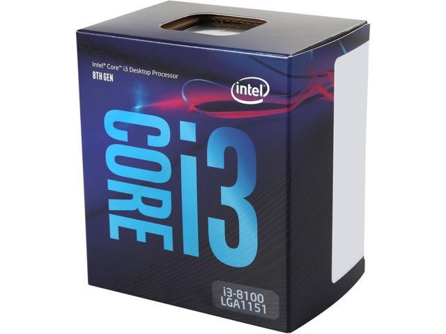

If I was putting together a Plex Server right now, I’d likely build around the Core i3-8100. Full Quick Sync support and 4 speedy cores. And just $120.
https://www.newegg.com/Product/Product.aspx?Item=N82E16819117822
(I’m curious what others think!)
Was $90 last week for the i3 at Frys. =) Plex upgrade and to 18.04 for me this weekend, with a $65 Corsair nvme card to free up extra sata ports.

One of my other plex machines, i5-6400, did 5 simultaneous x264 transcodes and CPU with overhead to spare. I’d have to go back and find logs for that. I don’t know what ceiling it hits.

Beautiful. You saw the Plex crew is beta testing the next-generation Transcoder in the preview channel? I haven’t tested it yet, but it is supposed to include hardware decoding of MPEG2.
