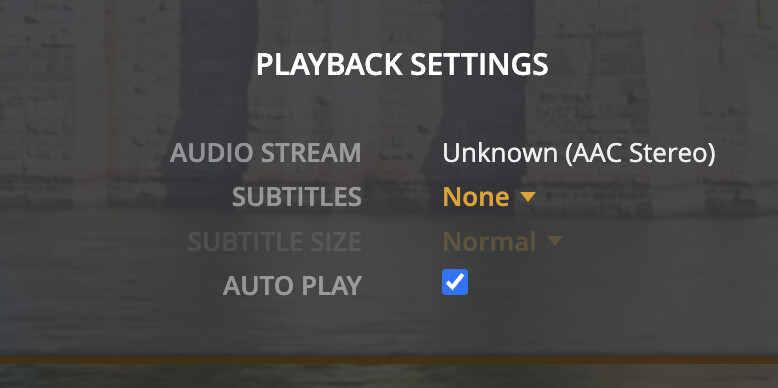

The New York Demo on the other hand doesn’t give me any option to change the video quality. It automatically transcodes to 1080p SDR. If I’m not mistaken, I was able to change the quality on 1.30.x. Anyway it looks like this version is indeed able to HW transcode properly.

As mentioned, I am able to change the quality for basically all my .mkv H264/HEVC content, but not for that LG New York demo you linked which comes in a .ts container. This is the UI I see, when playing it
while it should probably look more like this:
It looks like it is properly reading the meta data for the file as well
Not a big deal for me, since all my other files that I just tested are working just fine since. But maybe worth to look into if this version is supposed to be distributed to others who have their content in different containers.
I’ll spin it into a MKV. Willing to bet the TS container is the issue.
Here’s the file, as I downloaded it from LG’s web site.
This is the file you linked in another thread which I downloaded. I remuxed them into an mkv container which worked perfectly fine. I was able to change the quality of the demo in its new container. So I assume the file is just not perfectly suitable with Plex or at least this Plex version. I don’t think we have to look into it any further.
