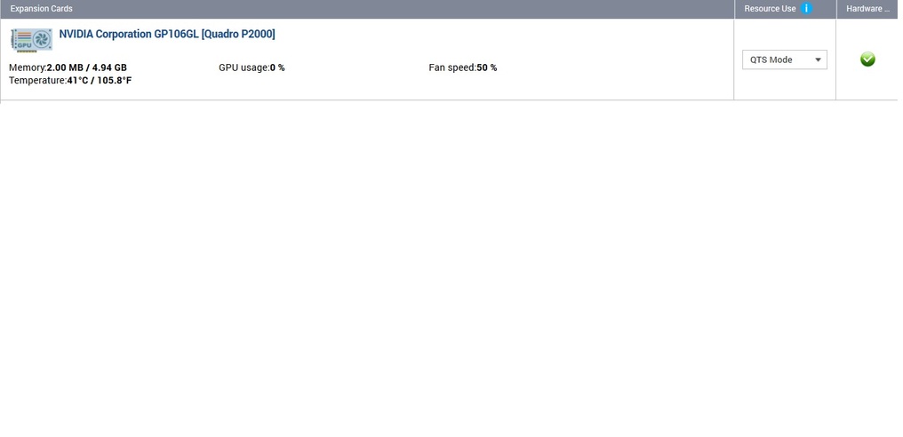

So even though I have plex pass and use hardware when available, plus the p2000 is now in QTS mode, it still does not perform the transcoding. At least as of this point. Bummer :disappointed:

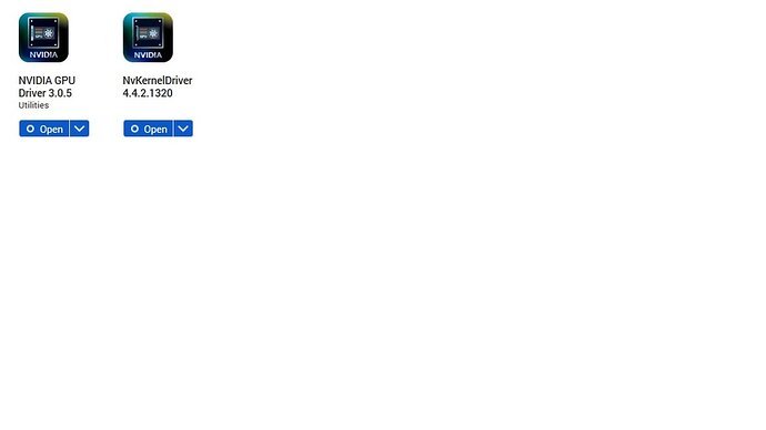

b)
gpuhal_app -s 1
active_status=2,real_status=2,driverqpkg=NVIDIA_GPU_DRV**,driver_installed=1**,in_used=none,transcode=1,display=1,pcie_slot=1,pcie_vp=1
Looks like drivers are ok no ?
c)
So Point 1 should be good no ?
so point 2 should be fine too
