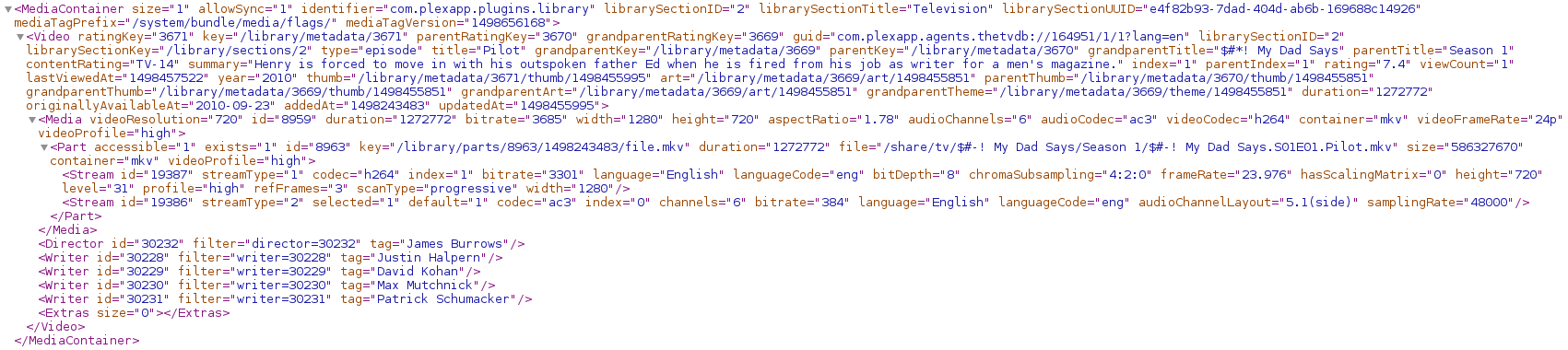

Here is the XML
<MediaContainer size="1" allowSync="1" identifier="com.plexapp.plugins.library" librarySectionID="1" librarySectionTitle="Movies" librarySectionUUID="40d3c5f1-63fa-42fa-8cc2-7d47cb537999" mediaTagPrefix="/system/bundle/media/flags/" mediaTagVersion="1498699072"><Video ratingKey="6016" key="/library/metadata/6016" guid="com.plexapp.agents.imdb://tt3541262?lang=en" librarySectionID="1" librarySectionKey="/library/sections/1" studio="CJ Entertainment" type="movie" title="The Admiral: Roaring Currents*" titleSort="Admiral: Roaring Currents*" originalTitle="명량" contentRating="Not Rated" summary="The film mainly follows the famous 1597 Battle of Myeongryang during the Japanese invasion of Korea (1592-1598), where the iconic Joseon admiral Yi Sun-sin managed to destroy a total of 133 Japanese warships with only 13 ships remaining in his command. The battle, which took place in the Myeongryang Strait off the southwest coast of the Korean Peninsula, is considered one of the greatest victories of Yi." rating="7.2" year="2014" tagline="12 ships against a fleet of 330." thumb="/library/metadata/6016/thumb/1499017897" art="/library/metadata/6016/art/1499017897" duration="7728128" originallyAvailableAt="2014-07-30" addedAt="1499017877" updatedAt="1499017897" ratingImage="imdb://image.rating"><Media videoResolution="1080" id="15463" duration="7728128" bitrate="2122" width="1920" height="800" aspectRatio="2.35" audioChannels="6" audioCodec="aac" videoCodec="h264" container="mkv" videoFrameRate="24p" audioProfile="he-aac" videoProfile="high"><Part accessible="1" exists="1" id="15490" key="/library/parts/15490/1490540586/file.mkv" duration="7728128" file="/Volumes/Data/Movies/English/The.Admiral.Roaring.Currents.2014.1080p/The.Admiral.Roaring.Currents.2014.1080p_cut.mkv" size="2050108894" audioProfile="he-aac" container="mkv" videoProfile="high"><Stream id="32840" streamType="1" default="1" codec="h264" index="0" bitrate="2122" bitDepth="8" chromaSubsampling="4:2:0" frameRate="23.976" hasScalingMatrix="0" height="800" level="41" profile="high" refFrames="5" scanType="progressive" title="TinyMoviez.co" width="1920"/><Stream id="32841" streamType="2" selected="1" codec="aac" index="1" channels="6" bitrate="192" language="한국어" languageCode="kor" profile="he-aac" samplingRate="48000" title="TinyMoviez.co"/><Stream id="32846" key="/library/streams/32846" streamType="3" selected="1" codec="srt" language="العربية" languageCode="ara" format="srt"/></Part></Media><Genre id="332" filter="genre=332" tag="Biography"/><Genre id="866" filter="genre=866" tag="History"/><Genre id="1478" filter="genre=1478" tag="War"/><Genre id="63" filter="genre=63" tag="Action"/><Genre id="65" filter="genre=65" tag="Adventure"/><Director id="9189" filter="director=9189" tag="Kim Han-min"/><Writer id="9190" filter="writer=9190" tag="Kim Han-min"/><Writer id="9191" filter="writer=9191" tag="Cheol-Hong Jeon"/><Country id="9206" filter="country=9206" tag="KR"/><Role id="4588" filter="actor=4588" tag="Choi Min-sik" role="Admiral Yi Sun-Shin" thumb="http://image.tmdb.org/t/p/original/abLCstRJLpuzG39KAiG7hD72zcn.jpg"/><Role id="9192" filter="actor=9192" tag="Kim Myung-gon" role="Commander Todo" thumb="http://image.tmdb.org/t/p/original/6fWyOkUhlp3SXzuG6oIxm5vbZtI.jpg"/><Role id="9193" filter="actor=9193" tag="Ryu Seung-ryong" role="General Kurushima" thumb="http://image.tmdb.org/t/p/original/A9GPyMsr9JUTAzo9YXkOZSd3lt7.jpg"/><Role id="9194" filter="actor=9194" tag="Jin Goo" role="Im Jun-yeong" thumb="http://image.tmdb.org/t/p/original/7pUYlQ9YmOnu5ZPHoqt18aMi6uC.jpg"/><Role id="9195" filter="actor=9195" tag="Ku Jin" role="Lim Jun-young" thumb="http://image.tmdb.org/t/p/original/1mIxYfjGOf1f8hTK1XhWhq18Xes.jpg"/><Role id="9196" filter="actor=9196" tag="No Min-woo" role="Haru" thumb="http://image.tmdb.org/t/p/original/x3PTDlNgGVujuKaezyP7lYdbbEW.jpg"/><Role id="9197" filter="actor=9197" tag="Ryohei Otani" role="Junsa" thumb="http://image.tmdb.org/t/p/original/CsrpvwRwDYFV5pc21cHXiKYMK5.jpg"/><Role id="9198" filter="actor=9198" tag="Lee Seung-joon" role="Captain Ahn Wi" thumb="http://image.tmdb.org/t/p/original/ak91z8vf4Xt3tWmOTyT1eQsN5WY.jpg"/><Role id="9199" filter="actor=9199" tag="Go Kyung-pyo" role="Oh Duk-yi" thumb="http://image.tmdb.org/t/p/original/9USMlxZS5GC5i5E2aEZkOtjeejX.jpg"/><Role id="9200" filter="actor=9200" tag="Lee Jung-hyun" role="Mrs. Jeong" thumb="http://image.tmdb.org/t/p/original/kYNjOkJ3HCiQAXf01Idr8lzHiHG.jpg"/><Role id="9201" filter="actor=9201" tag="Park Bo-geom" role="Bae Su-bong" thumb="http://image.tmdb.org/t/p/original/ve4rdacYMP5LJ7z8WEDVIRJfqDC.jpg"/><Role id="9202" filter="actor=9202" tag="Kwon Yul" role="Yi Hoe" thumb="http://image.tmdb.org/t/p/original/hBr9cRUHupRNeh0L8DqtQef8hWG.jpg"/><Role id="9203" filter="actor=9203" tag="Kim Tae-hoon" role="Kim Joong-geol" thumb="http://image.tmdb.org/t/p/original/mMM3lLicVbhgGRr0uaXkgfluPBe.jpg"/><Role id="9204" filter="actor=9204" tag="Cho Jin-woong" role="Wakizaka Yasuharu" thumb="http://image.tmdb.org/t/p/original/lZub9BpnfONDi1epmgNdHfubc9J.jpg"/><Role id="9205" filter="actor=9205" tag="JuShil Lee" role="Elder Jong-seon" thumb="http://image.tmdb.org/t/p/original/2MUDMgopRnLC4r6BveLj4Wgn7m3.jpg"/><Similar id="9208" filter="similar=9208" tag="Unholy Women"/><Similar id="9209" filter="similar=9209" tag="Don't Look Up"/><Similar id="9210" filter="similar=9210" tag="Planet of Snail"/><Similar id="9211" filter="similar=9211" tag="Possessed"/><Similar id="9212" filter="similar=9212" tag="Moss"/><Similar id="9213" filter="similar=9213" tag="Veteran"/><Similar id="9214" filter="similar=9214" tag="Kisses"/><Similar id="9215" filter="similar=9215" tag="The Ring Virus"/><Similar id="9216" filter="similar=9216" tag="The Chef of South Polar"/><Similar id="9217" filter="similar=9217" tag="Failan"/><Similar id="9218" filter="similar=9218" tag="Manhole"/><Similar id="9219" filter="similar=9219" tag="Prison on Fire"/><Similar id="9220" filter="similar=9220" tag="Violence at Noon"/><Similar id="9221" filter="similar=9221" tag="Hypnosis"/><Similar id="9222" filter="similar=9222" tag="No.3"/><Similar id="9223" filter="similar=9223" tag="Séance"/><Similar id="9224" filter="similar=9224" tag="Diary of June"/><Similar id="9225" filter="similar=9225" tag="New World"/><Similar id="9226" filter="similar=9226" tag="Voice of a Murderer"/><Similar id="9227" filter="similar=9227" tag="Christmas in August"/><Field locked="1" name="title"/><Extras size="0">
</Extras></Video></MediaContainer>

Now that you have the particular codec, it will not need to get it again unless the transcoder team has to update the codec library.
The only ‘delay’ you should experience now is the local delay when your server starts transcoding and initially fills the output buffer enough to start streaming to the player.
Out of all that, All you were interested in was:
This is telling us it needed to take the AAC 5.1 and convert it, most likely to AAC stereo (2 channel)
