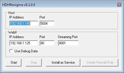

I don’t have an HDHR device but have an Enigma box with WebIf and got impatient waiting for DVR for Enigma from Plex. Not bugging them, it’s still in beta :slight_smile:
Anyways, I’m running PMS on windows so don’t want to delve into the possible linux solutions so I wrote my own self hosting web api which masquerades as an HDHR device and communicates with my Enigma box. I can now utilise the DVR functionality in Plex and record content from my Enigma box.
I’ve made the app available here for anyone else in a similar situation.
Some screenshots:

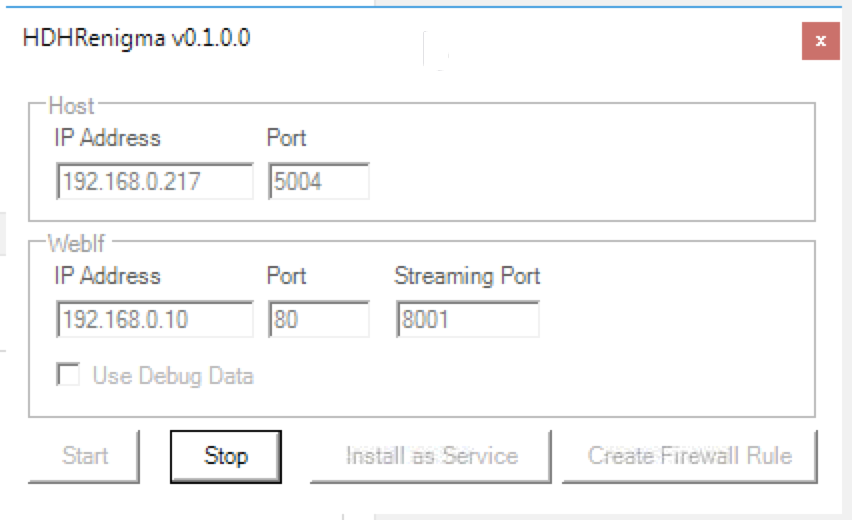

heres my config in the plugin:-
plexdvr, just gives me a spinner for a long while whilst searching for it, its also the same if I manually put in the ip for detection.
plexdvr will not be able to auto detect it. You’ll need to enter 192.168.0.217:5004 into plex, including the port.
ahh bingo, thats detected it!
