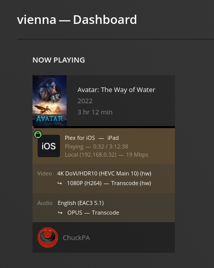

EDIT: Found it. There is a bug in the 8.18 version of the iOS app and its interaction with PMS 1.32.2.6992. It doesn’t invoke HW transcoding when it should.
Observe iOS left and Plex/web on the right
