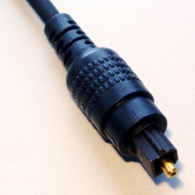

This is optical - center is optical fiber with metal covering for protection. Rectangular body, keyed so it can only be inserted one way.
TOSLINK
