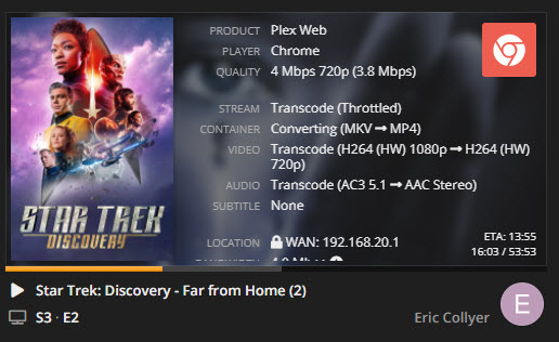

Hardware encoding is working for me using the following lines added to my config:
lxc.hook.pre-start: sh -c ‘chown :100000 /dev/nvidia*’
lxc.environment: NVIDIA_VISIBLE_DEVICES=all
lxc.environment: NVIDIA_DRIVER_CAPABILITIES=all
lxc.hook.mount: /usr/share/lxc/hooks/nvidia
2020-10-29_13-18-14
