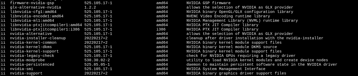

here is my dpkg -l | grep NVIDIA as it stands now.
I never do this. Those drivers are not vetted for Ubuntu or Debian. There have been many times when the “Nvidia bleeding edge” bites everyone.
You also need the DECODE package. So far, you show the encode side.
There are 3 pieces: 1. basic card - 2. Decode - 3. encode
I’ve found the best is to install the ‘server’ package nvidia-driver-525-server
