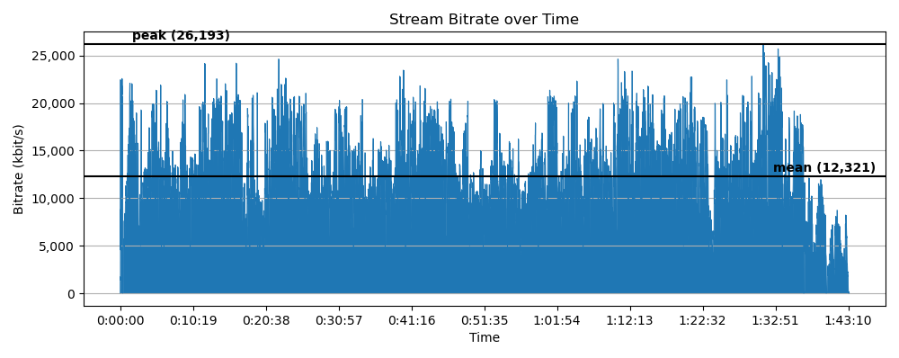

20Mbps CQ16 1080p + AAC (Video Bitrate = Peak: 26193 / Mean 12321)
Plex Deep Analysis results:
Entire MP4 file requiredBandwidths="18074,17605,16654,15348,14310,13910,13261,13261"
Video stream only requiredBandwidths="17913,17443,16493,15187,14149,13749,13102,13102"
AAC stream only requiredBandwidths="161,161,161,161,161,161,161,161"
Worst case = 17913
17913 + 5% = 18809
18809 < 20000 = No Transcoding! Plex will Direct Play with no buffering @ 20Mbps :slight_smile:

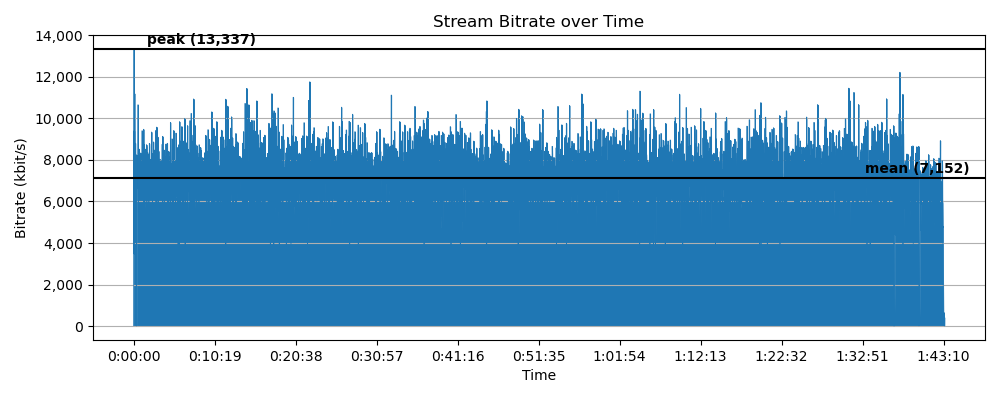

8Mbps CQ1 1080p + AAC (Video Bitrate = Peak: 13337 / Mean 7152)
Entire MP4 file requiredBandwidths="7475,7424,7376,7376,7376,7376,7376,7376"
Video stream only requiredBandwidths="7315,7263,7216,7216,7216,7216,7216,7216"
Worst case = 7475
7475 + 5% = 7849
7849 < 8000 = No Transcoding! Plex will Direct Play with no buffering @ 8Mbps :slight_smile:
