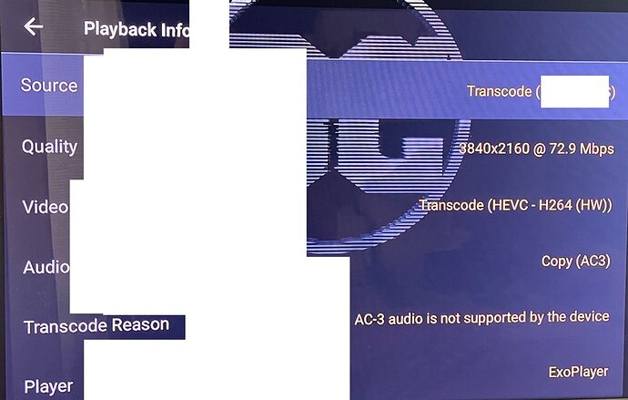

4k HDR10 mkv (UHD rip) is transcoding video on shieldTV with latest stable Plex server on QNAP. “Direct play” works fine on the same shieldTV with kodi with plexkodiconnect and direct paths (SMB). Client says that transcode reason is that audio is not supported even when it is supported ac3 and marked as Copy(ac3). Subtitles enable/disable don’t change the behaviour. My TV doesn’t support HDR10 and is only 1080p but shield TV should do HDR to SDR tone mapping and downscaling clientside without server needing to transcode, right? With older versions it resulted in washed out colors but worked without transcoding if I remember correctly.

Attached are mine from client side network logging. Included also playback info from the same session. Transcode reason is saying that ac3 is not supported but it is still copied to client and played ok…

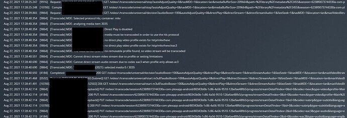

Can you provide me your server logs too? From the app logs, it shows it requested to direct stream the video but your server changed the decision to transcode.
@anon18523487 absolutely. Here it comes.
x-men-DP-server-log.txt (49.8 KB)
It looks like something is telling PMS that HDR is not supported for playback. Is the Shield set to use HDR? Does the TV you are using support HDR?
