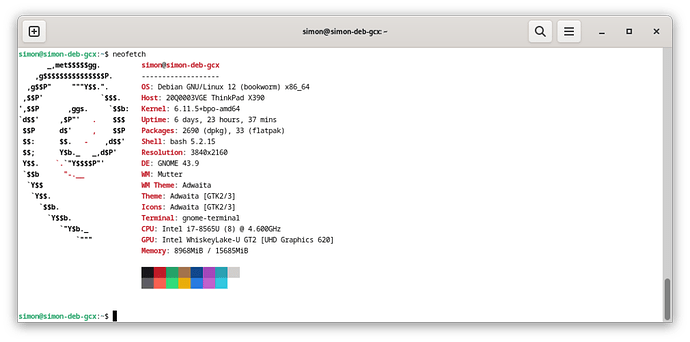

Just curious, but what linux distro are you using, what drivers are installed for your video card/intel igpu and what kernel are you running ?
This is most likely a hardware support related issue. I have a 13th gen intel and neither flatpak nor snap are able to use it. The complete same disk image works fine on my 7th generation intel integrated GPU. VLC and mpv also work fine.
snap (and flatpak?) packages include drivers, they are probably out of date. That’s why vaapi decoding with such new hardware probably fails.
Well, that might be true, but the hardware is about a year old now, so it is not THAT new any more. Furthermore I am also using the snap version of VLC and hardware acceleration is working fine there.
That’s pretty interesting, because it doesn’t work on 8th gen.
If the “bundled drivers” really are too old they must be REALLY old to make the cut-off between 7th and 8th gen Intel Core…
