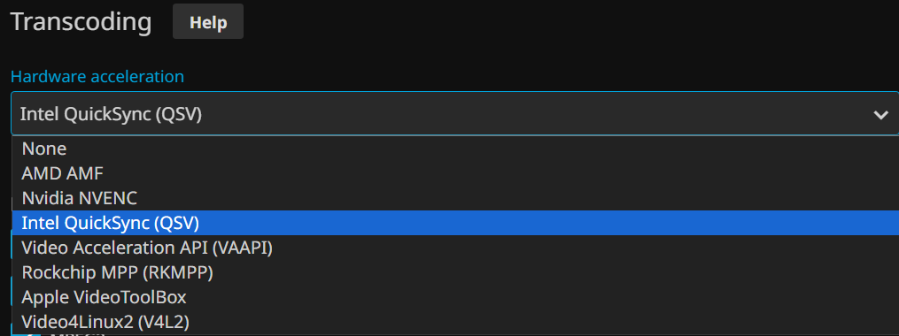

HW Transcoding with HDR Tone mapping not working (hw works without tone mapping enabled)
My Arc works fine too…until you enable tone mapping and try to transcode down HDR content to SDR. That’s the entire topic of this thread.
Tonemapping works good. Has worked good since last October.
I showed an example over here: Ubuntu 24.04 & HW transcoding - #160 by Menel
4 hdr tonemaps, on an old 7400t cpu and arc a310.
Your claims don’t match:
Plex isn’t able to support QSV on the Arc like Jellyfin has for over a year
Jellyfin on my test setup (Ubuntu 24.04, kernel 6.8, Intel Arc GPU).
These configuration haven’t been around for over a year.
My claim is that tonemapping on the Arc in Jellyfin has worked for over a year. I started testing it last year on kernel 6.2 in Ubuntu 22 and now tested it again on kernel 6.8 in Ubuntu 24. I’m not makng any claims about Plex. That’s why I’ve been in this thread trying to troubleshoot. It was @ChuckPa that just said Plex doesn’t support QSV on the Arc GPUs.
But if you’re saying you have the Arc working with QSV and tonemapping using the plexinc official container, I’ll give that a shot. I typically don’t use the official container, I prefer hotio. But I will test this out.
@Menel Where in this post are you showing proof that the Arc is doing the hw acceleration?
I stated:
QSV = Intel Quick Sync Video (in the CPU)
QSV != External GPU card.
If you’re going to paraphrase me, please get it right
I don’t understand what you’re saying. What does “PMS does not directly support Arc GPUs” mean?
Also, Arc external GPUs do use QSV. I have it working in Jellyfin and Tdarr. Are you saying that Plex only supports QSV on CPUs?
My overall question still stands. Why is Plex not willing to support QSV for Arc GPUs and/or VA-API tone mapping? Jellyfin does both with jellyfin-ffmpeg, that’s why I’m asking.

Thank you for for the clarification. Differentiating QSV hardware from the FFMEPG QSV API interface is very helpful.
Is there any reason Plex couldn’t use the QSV AVI interface if and only if an Intel GPU is set as the transcoding device? I assume this is how Jellyfin does it because you have to choose the type of HW acceleration you want to use.
