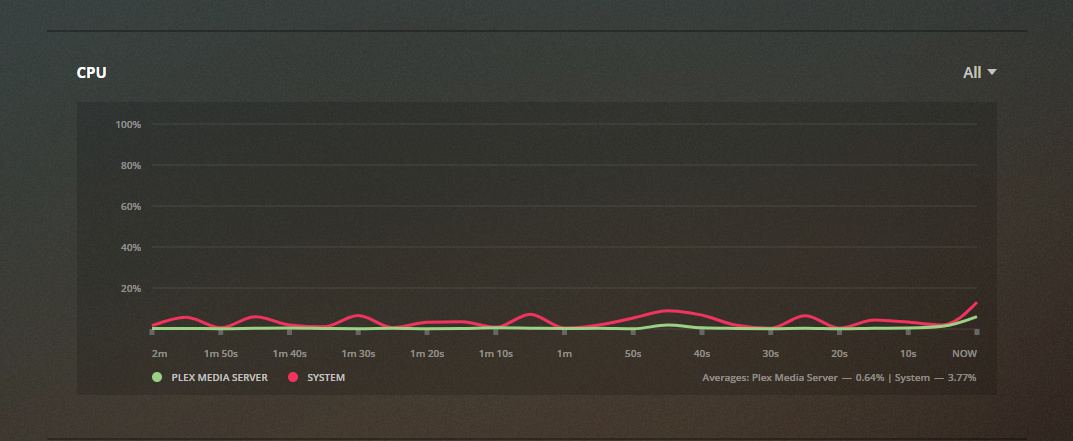

One transcode going at this moment:

I don’t do a ton, as it destroys storage but I believe roughly 15% cpu per stream, IIRC.
