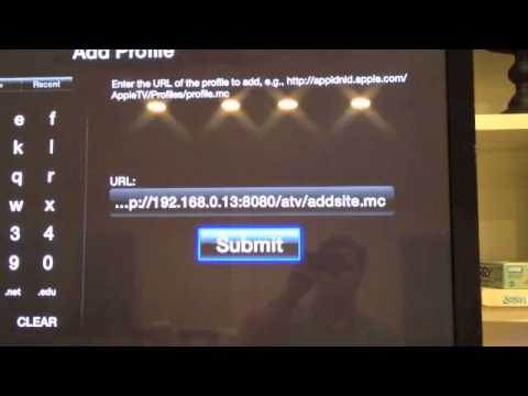

Hey all, I thought you might be interested in how "real" AppleTV apps get developed and installed on test units. There's a simple configuration profile that can be loaded onto the AppleTV (and a much easier way to load it than the configurator / usb dance), and from there, just point to the application, and bingo! a new app on the home screen.
Some details are in my blog post: https://intrepidusgroup.com/insight/2013/09/rpi-atv/ with links at the bottom to a demo video and a github site that has sample code (horribly ugly sample code, but you don't need the actual server here anyway), and slides from the DerbyCon talk where this was presented yesterday.

Where do we get these bag.plist files??? They make this look easy :slight_smile: i got the add site icon on my ios 5.2 :slight_smile: man if I could get a hbogo bag.plist that would be sweet! Ios 5.x+ thru 6.x+ apps on untethered ios5.2 yes sir! All I did was add the addsite.mc to my root directory then added it to the profiles where trailers.pem is already installed typed:
192.168.1.101:0000/myfolder/addsite.mc
Then reset my atv and there it was. Just like the video, but I went to profiles in my settings since I already had trailers.pem in my profiles.

@wahiman.j, you can take a sample bag.plist file from the github project in the guide: https://github.com/intrepidusgroup/rpi-atv/tree/master/Quickstart.

I tried the bag.plist but nothing new appeared on my atv.
Update
had to add http:// prior to my ip now i see a change new (in theaters) app. When I goto it it seems to be a clone of the trailers app. I can see plexconnect is now working on both apps. In theaters app is working exactly like trailers. No issues at all.
Vevo working :slight_smile: added http://appletv.vevo.com/bag.plist
