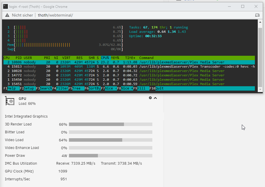

Posting Plex dashboard screenshots is completely useless if you are using HW transcoding as most of the load is one the GPU’s 3D and Video processing unit.
You need to use separate GPU statistics to really see the load. The following test was made with:
  • Unraid
  • i3-8100 with UDH 630 iGPU
  • RAM Transcoding
  • Movie on SSD with Direct Disc Access
  • Plex Docker Container on SSD with Direct Disc Access
1x 4K to 1080p without tone mapping:
1x 4K to 1080p with tone mapping:
The GPU load spikes constantly between 0% and the values you see in the screenshot +/-5%. The reason is because the buffer becomes full so the GPU can pause for a short time. Because of that its no problem to transcode 4x 4K with this iGPU.
As you can see the 3D load is a little bit higher with tone mapping. So I would say the maximum amount of 4K transcoding streams is reduced by 1x 4K stream.
The CPU load is nearly the same (not visible in the screenshot as it fluctuates to fast).
