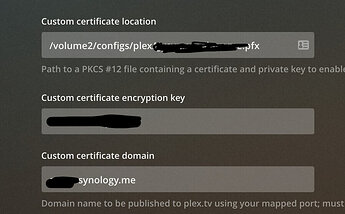

  • Under settings -> Remote access I have manually specify public port set to 20001.
  • Under settings -> network I have secure connection set to required.
  • I have generated my custom certificate and chosen a path for it, password etc according to to a guide I found in these forums but I cant post a link to it because I am a new user and only 2 links are allowed. I can post it in a reply if you need to see it.
One important thing worth mentioning is that I don’t have this problem at all when I go to settings -> network and disable secure connection…

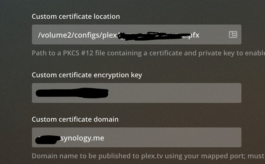

You mean basically just clear all these three fields on the server?
If I remove all this I can no longer access the media server through mobile data through my proxy.
You have an image on the reverse proxy, it is set to https? Or do you mean that the destination should be HTTPS?
I clear the three fields for custom certificate that I had a screenshot of above and instead added https://xxxxx.synology.me:20001 to the Custom server access URL. This made it possible to access the media server from mobile data but the dashboard still did not show it as a secure connection. Also it felt more laggy this way rather than not having anything in Custom server access URL and instead fill in the three fields from the above screenshot.
