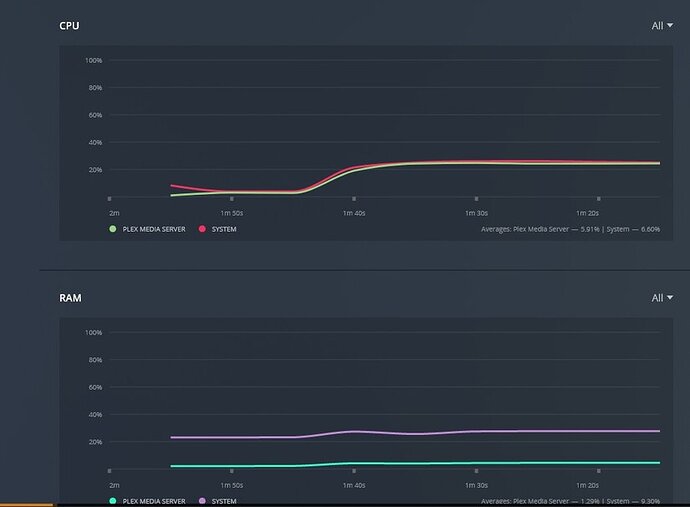

I also attached a screenshot of the server CPU/RAM attempting to transcode the original anime. It doesn’t seem to be trying hard?

Now, when I attempt to play the first series via the web (I don’t have control of the Samsung TV right now), it acts the same (stutters hard and takes forever for buffering) and I don’t see much pressure on the CPU. I know you said the burn-in of the subtitles would kill the CPU, but I am just not seeing that.
