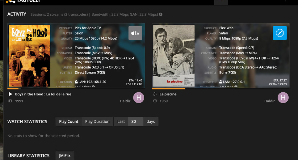

Thx for your feedback, I have tested ubuntu with a intel 8700 and no docker for the moment and i get better performance for transcoding :
Using MacOS, both movie get less than 1.0 for transcoding :frowning:

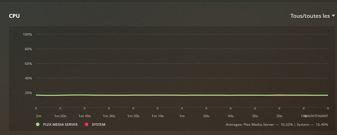

What could expect throttling for transcoding even if the cpu is “low” on ubuntu?
I’m using 4K files to stress the transcoding engine and be sure, the gpu is not enough “fast” to manage all the movies one by one with enough buffer to miss the buffuring.

  1. This is showing PGS (image based) subtitles. Image based subtitles must always be burned by the CPU. Intel did not provide a means to do this in hardware.

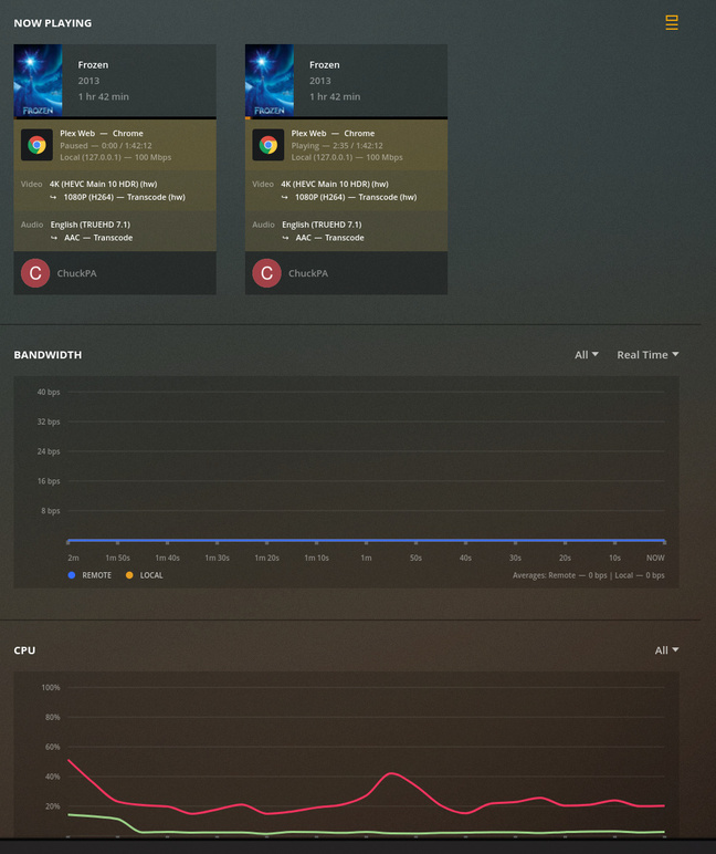

I have an i7-8809G (both the 8700’s 630 GPU + AMD GPU onboard).
Here is running on this NUC8 (i7-8809G CPU).
Media is on the NAS
Source media is 61 Mbps 2160p transcoding and playing into Plex/Web
