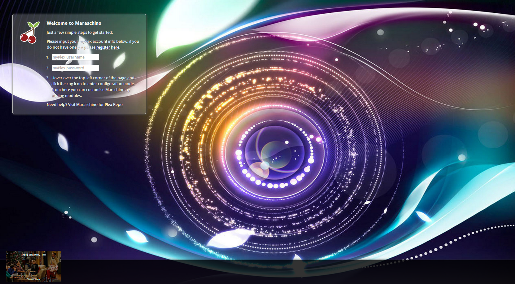

Pushed a few big changes today. I know there will be bugs as I have been perfecting the communication handling with plex.tv so that things can fail gracefully and inform the user why it might have happened. There is also now the ability to set the preferred section for each recently added module.
As always feedback is welcome and encouraged!
edit: Also forgot to mention Maraschino should register properly with plex devices now and will show the icon for the OS it is running under:

Okay, finally got it to run and get my information but for some reason it just will not show any colums! See's something is playing but that's bout it. The log looks like this:
[root@media maraschino-plex]# python Maraschino.py
19:23:32 :: INFO :: Opening database at: /var/www/html/maraschino-plex/maraschino.db
19:23:32 :: WARNING :: Opening database failed
19:23:32 :: WARNING :: Checking if PATH exists: /var/www/html/maraschino-plex/maraschino.db
19:23:32 :: INFO :: Database successfully initialised
19:23:32 :: INFO :: Creating dir /var/www/html/maraschino-plex/cache/trakt/shows
19:23:32 :: INFO :: Creating dir /var/www/html/maraschino-plex/cache/trakt/movies
19:23:33 :: INFO :: UPDATER :: Checking for updates
19:23:33 :: INFO :: Starting Maraschino on 0.0.0.0:7000
19:23:33 :: INFO :: Plex :: missing myPlex username or password
19:23:34 :: INFO :: UPDATER :: Up to date
19:23:40 :: WARNING :: Could not retrieve number of columns settings. Defaulting to 3.
19:23:51 :: INFO :: Plex :: Successfully saved Plex credentials
19:23:51 :: INFO :: Plex :: Updating plex server information
19:23:52 :: INFO :: Plex :: Adding PlexServer Media to db
19:23:53 :: INFO :: Plex :: Adding PlexServer Robbie-PC to db
19:23:53 :: INFO :: Switched active server to ID 1
19:23:54 :: INFO :: Plex :: Successfully updated  sections
/var/www/html/maraschino-plex/modules/plex.py:157: DeprecationWarning: In future flask releases etags will no longer be generated for file objects passed to the send_file function because this behaviour was unreliable.  Pass filenames instead if possible, otherwise attach an etag yourself based on another value return send_file(img, mimetype='image/jpeg')
19:23:57 :: WARNING :: Could not retrieve number of columns settings. Defaulting to 3.
19:24:09 :: INFO :: Switched active server to ID 1
19:24:16 :: WARNING :: Could not retrieve number of columns settings. Defaulting to 3.
19:25:04 :: INFO :: Switched active server to ID 1
19:25:07 :: INFO :: Switched active server to ID 2
19:25:08 :: INFO :: Switched active server to ID 1
Move your mouse to the upper left corner of the browser window and a gear icon should appear.  Click on that and you can add modules to the page.
