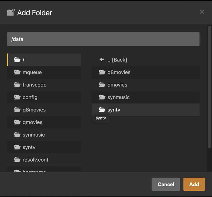

I mounted a new share today and I cannot get the folder to appear in the “Add Folder” list in the “Manage Libraries” tab. I double checked all my permissions and it matches all my other shares. When I log into the bash shell in the docker container, I can see the directory is mounted correctly, I can browse the directory, and I can read the media files in there. When I try to manually add the directory myself in the “Add Folder” list, it does not find any data. Looking for any help here as to what I could be missing.

It is visible though in the container’s bash shell. It’s not in Plex.

When I then look at in plex, it is not showing the q8tv directory:
It doesn’t matter how I name the new directory, where I put it in the container’s filesystem, where it is in the yaml file, or if it is NFS or CIFS. The newly created directory always appears fine in the container’s bash shell, but plex doesn’t want to see it.
As you see there:
/data/syntv/
What happens when you click into it? Do you see the TV series?
