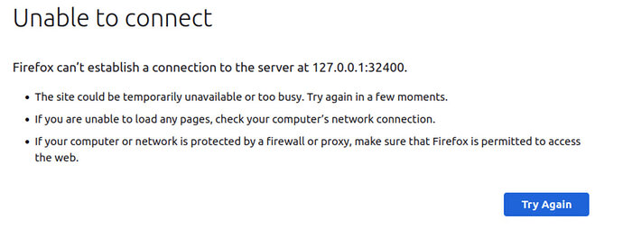

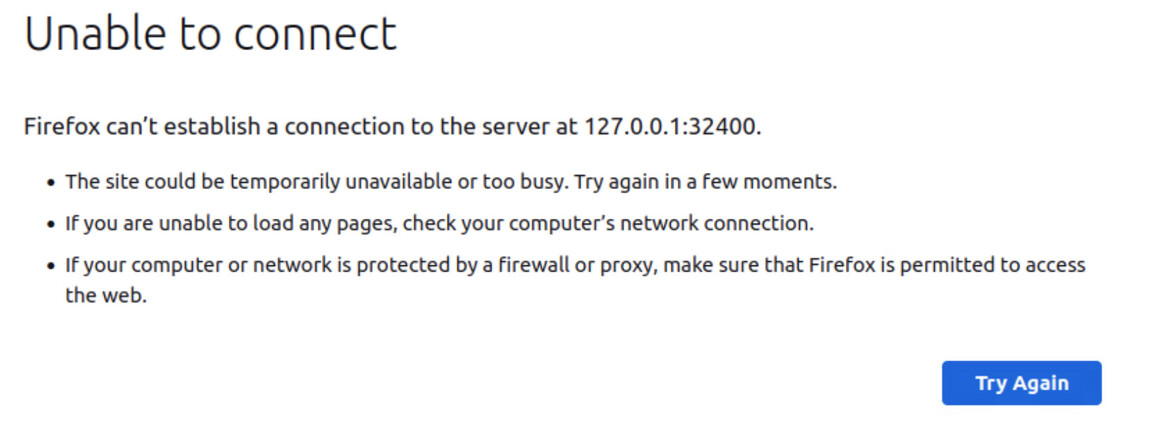

After making that change however, it seems to have broken it :slight_smile:
Plex now wont load. I’ve tried installing it once more. There were no errors during install:
Looking at the logs, I receive the following:
Any ideas on what could have caused my new issue?
Thanks everyone!
