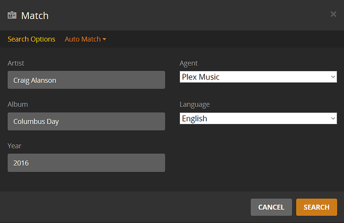

Actually, Plex Music now uses Musicbrainz as a source. Musicbrainz supports audiobooks. So Plex supports audiobook metadata as long as the source database (which is community-edited) has that data. @Bjoure, if Musicbrainz isn’t finding an audiobook, I suspect it’s because no one has added it there yet—not because the agent talking to it is broken.
https://wiki.musicbrainz.org/Style/Specific_types_of_releases/Audiobook
https://support.plex.tv/articles/upgrade-music-libraries-new-metadata-system/#toc-0
Music in Plex starts with the best-in-class database of music content from MusicBrainz and then also adds in the best-in-class musical metadata from AllMusic.
(By the way, Columbus Day is in MusicBrainz because I personally added it.)
