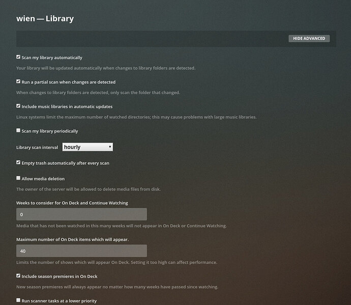

You can avoid a lot of pain (but not all) with the following server settings.
server > settings > library
  • enable scan automatically
  • enable run partial scan
  • disable include music
  • disable scan periodically (it still will)
  • set scan interval > daily (daily is the max, there is no “NONE”)

  1. Periodic Scan - OFF (uncheck the box = OFF )
  2. Enable Partial Scan

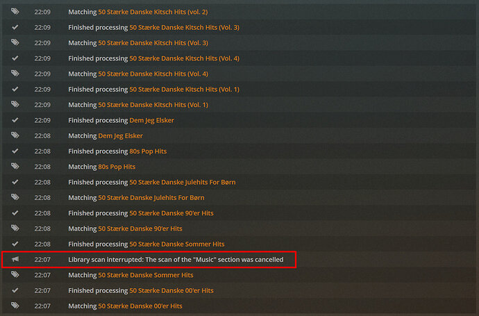

The main challenge for me is, that there is no way to exclude/skip the unmatched albums. Which means, everytime a change is made in the library - all unmatched albums/tracks are rescanned (up to 3-5 times on a single file change - more info in this thread).

Would it maybe be an idea, to limit scanning unmatched albums (if not found by first scan) .. to the maintenance schedule? This way, the Plex proxy won’t get hammered all the time (for most users) .. and it would be a much better experience for the users, which has unmatched albums. You would still be able to manually match.
Most of my unmatched albums is by Various Artists (compilations) and local artists/albums (Denmark)
Cancel scanning doesn’t stop the job:
