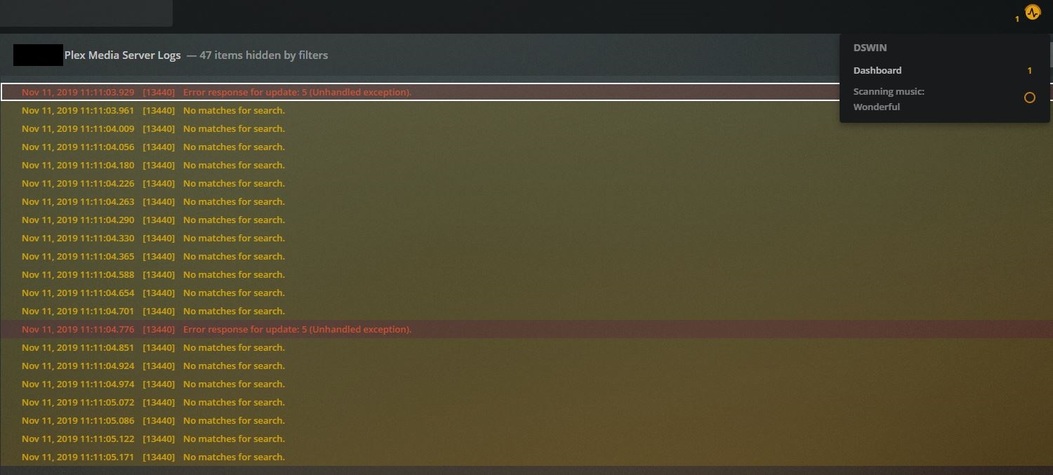

I have been noticing with the new music scanner that when something changes the spinner in the top right (that is shared with the dashboard link) will go through a number of items and then sit on one for a very long time (i.e. anywhere from 2 - 10 minutes) even if the new changes have already been updated.
I went into the console and noticed the following:
Drilling down into the errors show:
In the file system I searched for everything with Wonderful in it (e.g. Adam Ant) and removed them to see what would happen and then it sits on another item (e.g. Greatest Hits) but that starts to become tedious to try and narrow down the issue.
So I have downloaded the logs locally and since there is a lot of logs in it, I was wondering what I should be looking for as I suspect it must be some items causing this (as per the above it appears like 5 items?).

Nov 11, 2019 14:37:24.014 [3452] ERROR - Error response for update: 5 (Unhandled exception).
Nov 11, 2019 14:37:24.035 [3452] WARN - No matches for search.
Nov 11, 2019 14:37:24.085 [3452] WARN - No matches for search.
Nov 11, 2019 14:37:24.101 [3452] WARN - No matches for search.
Nov 11, 2019 14:37:24.252 [3452] WARN - No matches for search.
Nov 11, 2019 14:37:24.294 [3452] WARN - No matches for search.
Nov 11, 2019 14:37:24.316 [3452] WARN - No matches for search.
Nov 11, 2019 14:37:24.334 [3452] WARN - No matches for search.
Nov 11, 2019 14:37:24.362 [3452] WARN - No matches for search.
Nov 11, 2019 14:37:24.380 [3452] WARN - No matches for search.
Nov 11, 2019 14:37:24.491 [3452] WARN - No matches for search.
Nov 11, 2019 14:37:24.516 [3452] WARN - No matches for search.
Nov 11, 2019 14:37:24.532 [3452] WARN - No matches for search.
Nov 11, 2019 14:37:24.568 [3452] ERROR - Error response for update: 5 (Unhandled exception).
Nov 11, 2019 14:37:24.592 [3452] WARN - No matches for search.
Nov 11, 2019 14:37:24.632 [3452] WARN - No matches for search.
Nov 11, 2019 14:37:24.647 [3452] WARN - No matches for search.
Nov 11, 2019 14:37:24.716 [3452] WARN - No matches for search.
Nov 11, 2019 14:37:24.731 [3452] WARN - No matches for search.
Nov 11, 2019 14:37:24.746 [3452] WARN - No matches for search.
Nov 11, 2019 14:37:24.808 [3452] WARN - No matches for search.

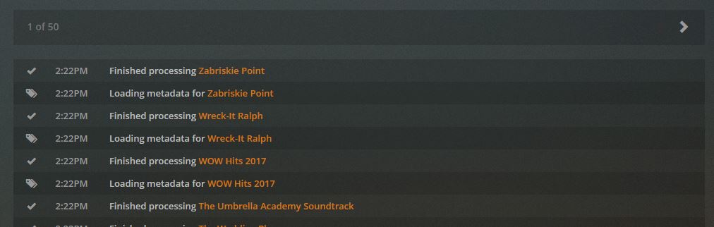

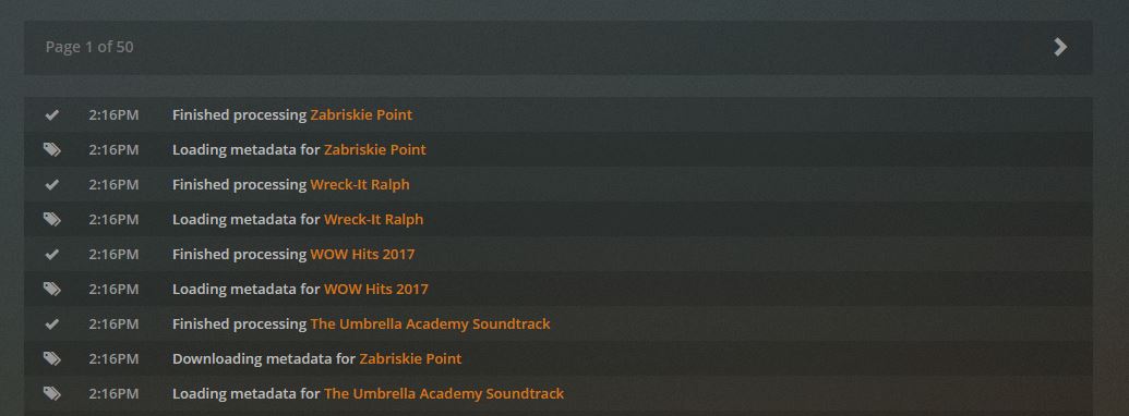

In doing more testing, I have also been noticing that if I trigger a scan (i.e. move a music folder out of the library, move a music folder back into the library), the alerts area shows all of the loading and processing of metadata, but it appears to be scanning things it has already scanned and processed.
First scan:
Second scan:
The time stamps are different but the entries are the same.
This seems odd as I have the Run a partial scan when changes are detected turned on, meaning I would think that I would only see the changed file(s) here.
