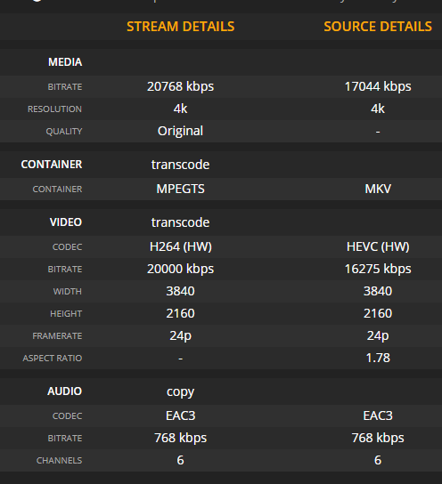

Oh, so would you mind sharing some details? For me this looks exactly like the issue discussed in this thread. Kodi playing 10 bit HEVC files, while the official app doesn’t.

[MediaDecisionEngine] Unable to direct play; Direktes Abspielen ist nicht möglich, da diese Mediendatei mit diesem Gerät nicht kompatibel ist.
Translated: Direct play isn’t possible because the media file isn’t compatible with this device.
Your file has DTS audio. The device does not support DTS audio, nor can it pass-through DTS, so Plex has to transcode the audio. When audio gets transcoded, the device is also unable to direct stream HEVC so it has to transcode the video as well.
Well sorry, but no. The device (Fire TV 3) CAN direct play H264 files with DTS (and DTS-HD) just fine. It also CAN direct play the same file (HEVC + DTS) using Plex for Kodi. For me it looks like the “MediaDecisionEngine” isn’t working properly.
Oh, my last response was wrong. Although the device does not support DTS, we added the ability for the app to decode DTS locally. Sorry about that.
Can you provide me the XML for that video? It doesn’t show in the log, but I think it has to do with the video being 10-bit. I was checking the app, and we do have an 8-bit bitdepth limit. I don’t know if this is just a carry over from the 2nd gen device which would not play 10-bit video or if it is intentional. I’m looking into this limit.
Yes, the Video is 10-bit:

I’ve encountered the same problem: Kodi says “yes” and do a direct play - Plex says “no”
I’m having the same issue. 10bit HEVC videos are transcoded when played through the native Fire TV Plex app- but can be direct played/streamed fine through the Plex Kodi add-on.
I realize this post is old, but I did a bit of research and wanted to post an update for any others who might find this in the future (or are still struggling with it).
I sideloaded Plex for Android on my Fire TV (Gen 2) running Fire OS 5.2.7.2: https://developer.amazon.com/docs/fire-tv/device-specifications-fire-tv-pendant-box.html?v=ftvgen2. HEVC 10-bit direct playback works with Plex v4.25.2.588. It does not work with Plex v4.26.2.654 (or any subsequent versions). Whatever change was made in between those versions caused it to stop working.
When playing an HEVC 10-bit file in v4.25.x (or earlier), a message pops up that says “Optimizing for Ultra HD Playback” and playback then works as expected. That doesn’t appear in later versions.

No…those are correct. I had to sideload an older version of Plex in order to get HEVC 10-bit direct playback working. Direct playback is not working with v7.25.0.
On anything higher than 6.12, Plex refuses to even transcode HEVC Main 10 files, let alone direct play them, on the Fire TV Stick.
