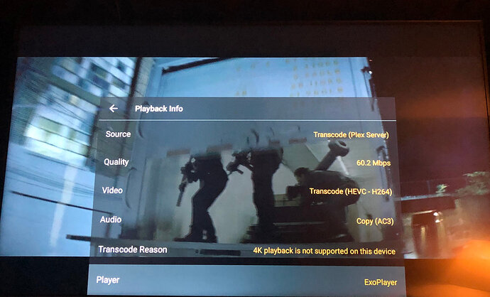

OK can you please when playing something go to the playback info and see what it says for Transcode reason. I’m guessing it says it exceeds allowed bandwidth, even though you actually have home and remote streaming on maximum.

Hi,I am using a 4K Fire TV stick connected to LG Oled,Having exactly the same problem from last night found a temporary method to play the 4K HDR videos. just manually select the video quality to 1080p and again select the " Play the Original Quality" option ,It will automatically Play the videos on original quality.
