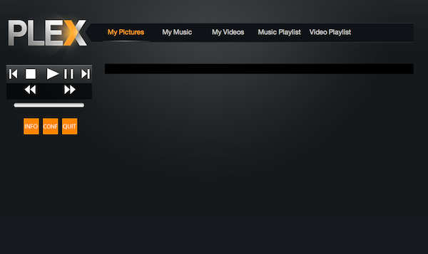

I don’t have much so far, but here’s a sneak preview (mostly a mash up from furby’s design and plexapp.com). The controls aren’t were I want them yet, they are just floating for now, I’ve been working on the header/banner links up until now and I am just starting to play with the divs for the left and right (the black bar) content.
That’s really nice, I’ll be looking out to see how it comes along. Yes, agree totally about the large use of images, it’s not the way I would have coded it and am currently fixing that.
