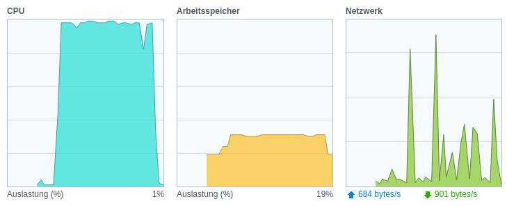

Edit: Tested with the 120 mbps video
It took something like 1m30 to 2m to even start streaming. I tested on my iphone remotely and the video was converted from HEVC to h264 with hardware transcoding enabled. I didn’t test the 400mbps one because i don’t think it would run better and i didn’t test without hardware transcoding.
All in all: 4k not really usable on this box.

ChuckPA/all - I took the plunge and purchased the DS418play. Overall, it’s great. However, I am having one issue that I simply cannot resolve.
I have installed Plex with no issues. All my media is transferred and everything is working swimmingly except live video. Live video buffers often, every 10-60 seconds when watching HD channels; SD channels play flawlessly. The buffering happens regardless of client including PC, iPhone 7, and Roku Streaming Stick+. The DS418play does not show any issues when transcoding live streams;CPU stays ~60%, RAM and everything else is nominal. I have dug through the logs, even the verbose ones, and haven’t been able to pick out the pertinent lines. I’m hoping for some help, and I’m sure this can be resolved as all the monitoring shows the DS418play is well within its limits.

Finally, also included are screen captures of the NAS utilization during live transcoding, as well as the Plex status screen showing hardware acceleration. Of note is that while the processor utilization of the DS418play did jump to ~60 percent, it did stabilize there and did not change while the buffering was occurring. Also, network and disk utilization are nominal.
