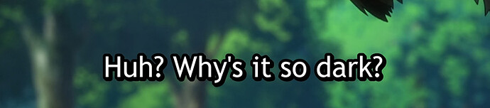

Some subtitles look a bit squeezed.
Plex:
Vlc:
