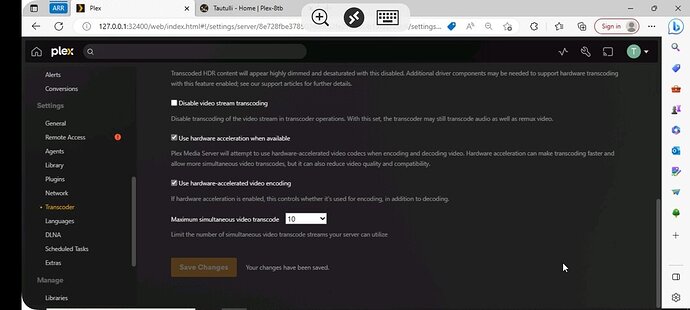

I am trying to chase down issue of plex buffering. This issue didn’t used to happen few weeks ago, all the sudden since 2 weeks ago everything I play is buffering every 15-30 seconds. I cant seem to figure out why. I am not Sharing my plex and I only use it to stream locally from my projector (smart project that has a plex client app) all my files are either 4k with atmos/trueHD/DTS-HD/X and some are 1080p
I have plex running on an old gaming pc that has a 5th gen Ryzen cpu and rtx 2060 super graphics card. I am using Ethernet to connect my pc to the router which is 1gb. This PC is not used for anything else. Latest plex version is installed, I pay for plex pass and enabled hardware transcoding.
Plex server is installed on my C drive which is an ssd but all my media is on D drive which is a HDD (segate barracuda 8tb)

Adding screenshots of the transcoding settings
